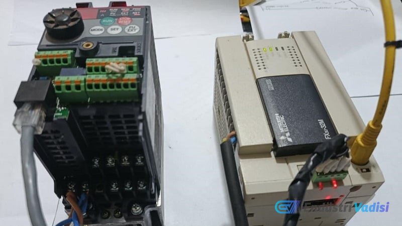

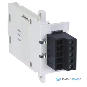

In the example application, a connection is made between the FX3U PLC, equipped with an FX3U-485-BD expansion card, and the FR-D700 inverter via a shielded twisted-pair cable. The FX3U-485-BD card provides serial communication and must be used with appropriate hardware. The inverter supports Mitsubishi protocol and Modbus commands via its RS-485 interface.
- SDA and SDB differential signal pairs are used for RS-485 connection.
- The SG terminal is required for ground reference.
- The connector on the VFD side is an 8-pin RJ45 (not the 6-pin RJ12 common in RS-232/RS-485).

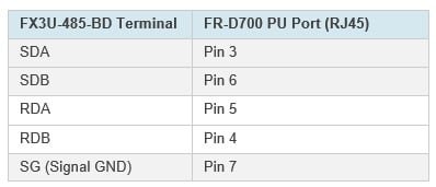

### FR-D700 and FX3U-485-BD Pin Mapping
Pin configuration and connections are detailed in the table. VFD parameter settings must be configured to match the serial communication protocol.

- The SD and RD LEDs on the FX3U-485-BD indicate data transmission/reception status.
- If only the SD LED is lit, it means no response has been received from the device. In this case, connections, address, and parameters should be checked.
