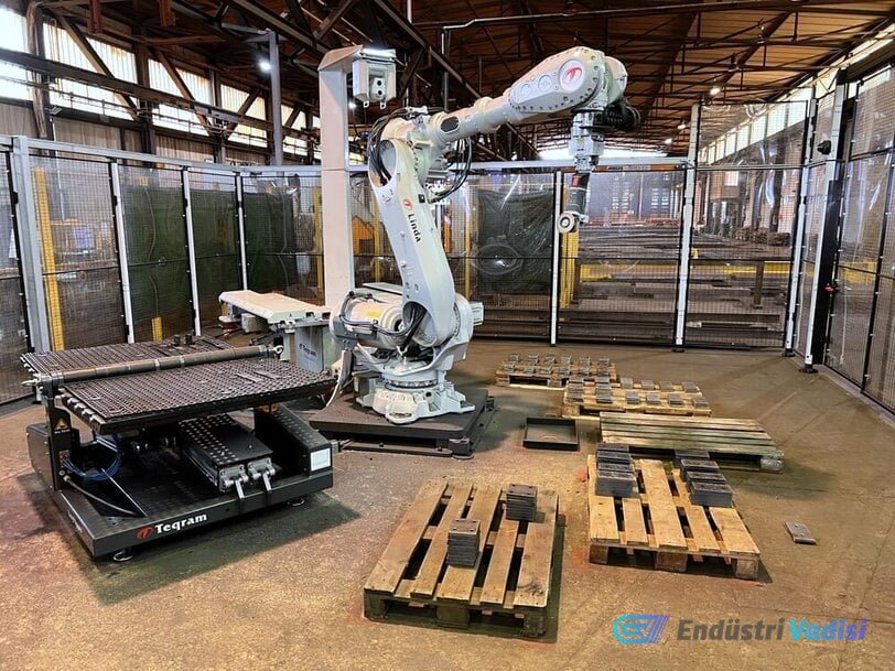

    Claus Queck GmbH has taken a significant step by integrating Teqram's AI-powered EasyGrinder robot for deburring and grinding flame and plasma-cut steel parts. Previously, manual grinding created a production bottleneck due to inconsistent surface quality caused by worker fatigue and physical strain. Thanks to the EasyGrinder, Stahlbau Queck can now reliably achieve the P3 preparation grade required for demanding projects like those for Deutsche Bahn.
    👁️ Smart Vision, Flawless Results​
    Equipped with advanced 3D vision technology, the EasyGrinder autonomously recognizes part geometries and applies the optimal grinding sequence without requiring manual programming or teaching. This robot, affectionately named "Linda" by the workshop team, has significantly improved workplace ergonomics and safety by taking over heavy and repetitive tasks. This transition provides Stahlbau Queck with fully repeatable surface quality, reducing the need for costly rework, while enhancing its competitiveness in international tenders and attracting talent seeking modernized work environments.
