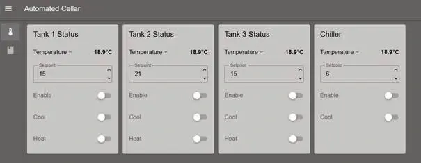

Node-RED offers a library of user interface controls that can be used within the application to allow for user interaction for the frontend environment. When the Node-RED dashboard is installed, you get a full-stack environment with the ability to create edge server applications that can interact with factory equipment and IT infrastructure.

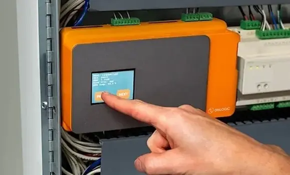

The Raspberry Pi is a single-board microcomputer. It runs a Linux-based version and has become quite popular among DIY and hobby electronics enthusiasts. The Pi has become so popular that industrial versions are even available with DIN mount capabilities and industrial enclosures, such as the Factor series IPC from OnLogic.

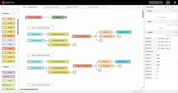

The interface is accessed by entering the IP address of the device. Node-RED loads in a web browser. The palette is located on the left side of the screen and contains all the nodes your project can access. Additional nodes can be installed through the palette manager, similar to NPM packages. The right side contains node properties, debug windows, and dashboard configurations. Each program consists of flows made up of nodes that perform different operations on the payload, such as change, switch, delay, and function. The payload can be a string, an array, or a JSON object and flows from left to right between the nodes. The source of the payload can be from the dashboard, hardware I/O, or communication nodes.
Multiple flows can be added, and payloads can be passed to different flows, or you can store payloads in context stores. All these features allow the user to create well-organized flows that are easy to read and understand.
If there isn't a node that does what you want, you can use the function node, which allows you to write JavaScript code that can take inputs, modify the payload, and produce different results. If you don't want to program it yourself, the palette manager has over 5,000 different nodes created by the Node-RED community that can be made available to you without paying any licensing fees.
