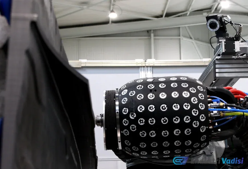

    IDEKO designed an intelligent robotic cell that combines milling, drilling, deburring, and in-process inspection. The system includes the following features:
    • Photogrammetry and computer vision technologies for continuous tracking of the robot's end effector in large volumes.
    • Predictive metrological models for real-time position correction.
    • Automatic camera positioning along the process path.
    • Automatic referencing when the part is fixtured.
    • Adaptive tool path generation based on measured geometry.
    This architecture reduces positioning errors during machining while eliminating the need for extensive manual calibration and increasing process repeatability. Furthermore, advanced sensor systems monitor vibrations and process parameters, detecting irregularities that could affect surface quality and hole integrity at an early stage.
