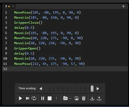

    3. Design the motion program in the MecaPortal code editor.
    4. Set the speeds for the three motion types:
    - SetCartLinVel(100) (Linear speed)
    - SetCartAngVel(45) (Angular speed)
    - SetJointVel(25) (Joint speed)
    5. To determine target points, use the jogging interface to move the robot close to the target. This clarifies the axis directions.
    6. Motion commands are usually MoveJoints or MovePose. However, MoveLin is preferred for situations requiring precise gripping.
    7. Gripping motions are controlled with GripperOpen and GripperClose commands.
    ### Example Program Flow
    • Go to the gripping position in front of the robot
    • Move forward with MoveLin
    • Close gripper and short wait
    • Return to the starting position
    • Move to the release position to the left of the robot
    • Open gripper and wait
    • Return to the final position
    • Move to a random intermediate position
