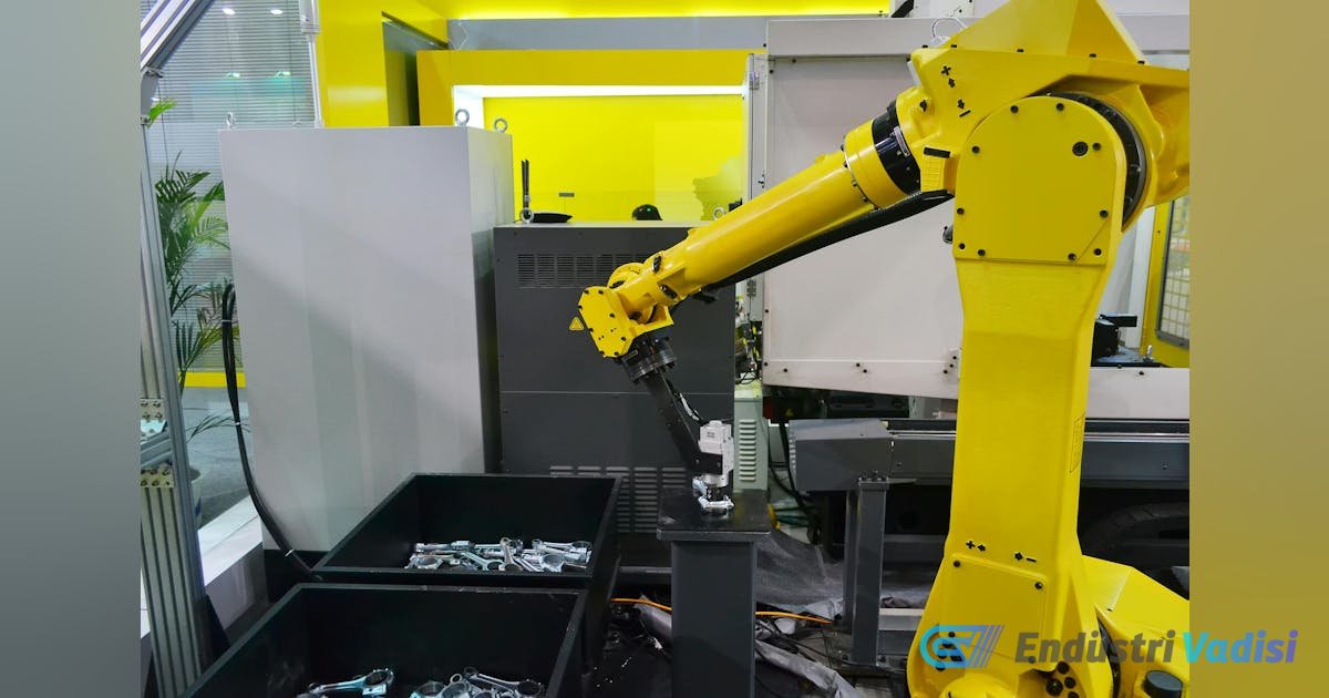

Imagine a factory. Next to a robotic work cell, a digital monitor displays a live view of a deep bin filled with randomly placed mechanical components. As a new bin arrives, the machine vision software quickly initiates an inference process. On the screen, the target object is identified and isolated with high statistical probability. Yet, the six-axis robotic arm in the physical work cell remains motionless; the robot, it seems, still lacks the information needed to move. This operational gap highlights one of the most significant inconsistencies in modern machine building: object detection is the preliminary output of a robot-vision system, not its ultimate goal. To bridge this gap, engineering teams must examine strategic decisions focusing on spatial calibration, deep sensor integration, rigid trust rules, and adaptive mechanical execution.

Consider a complex, real-world manufacturing scenario, such as a bin-picking application where hundreds of industrial screws are randomly dumped into a deep bin. In this environment, a 2D vision system is fundamentally inadequate; a flat image cannot determine if a screw is on top of the pile or buried at the bottom, nor can it distinguish between a large screw resting deep within the bin and a smaller one resting just beneath the lens. The automation system must combine 2D intelligence with 3D physical data by pairing specialized deep learning vision models with advanced 3D depth sensors, such as structured light cameras or time-of-flight sensors.
This hybrid approach executes a clear, multi-step engineering workflow to transform a flat shape into a tangible physical target. First, isolate the component through segmentation masks that distinguish the object from its background. Then, the system overlays this 2D pixel mask onto the real-time depth map generated by the 3D sensor. In the screw bin example, combining the 2D mask with 3D depth data allows the software to analyze sudden height changes at the edge of a part, determining which screw is resting on top and which parts are buried underneath. Once an unobstructed screw is selected, the system analyzes the clustered 3D points within that part's specific segmentation mask. This step maps a true physical object occupying a specific volume in space, calculating the object's precise orientation and physical surface topology. Finally, the automation software evaluates the calculated surface topology to select an optimal gripping point. For a robotic arm equipped with a magnetic or mechanical gripper, the system must find a flat, stable surface area on the head or body of the screw. This step also verifies that the robot's physical jaws or magnetic tool can cleanly grasp the target without colliding with adjacent, overlapping screws or the rigid walls of the bin.
