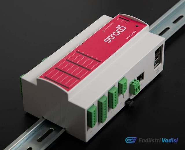

    💾 Hardware Redundancy Matters Too​
    The Strato Pi Max is a modular industrial platform based on the Raspberry Pi Compute Module. Its dual SD card configuration allows for two complete systems to reside on two independent SD cards. The Strato Pi Max microcontroller controls storage routing and can switch between them. This means the A/B concept isn't limited to two partitions on a single storage device. Each side can reside on separate physical media, ensuring a recovery system remains available even if one device fails.
    🛠️ A Hardware/Software Stack Designed for the Problem​
    Sfera Labs and Silitics have created a particularly effective hardware and software stack by combining the Strato Pi Max's hardware foundation, which provides independent storage and hardware supervision, with Rugix's software layer for reproducible Linux images, updates, rollback, and controlled system state.
    Rugix consists of RugixBakery, which creates system images and update packages, and RugixCtrl, which runs on the target device and manages updates, A/B slots, and rollback.

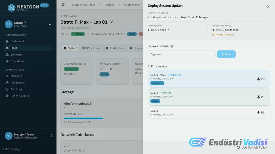

    🚀 Sending the First Update​
    To demonstrate an update, the LED interval is changed from 500ms to 100ms, and the image is rebuilt. The resulting .rugixb package is transferred to the device and installed using RugixCtrl. While skipping signature verification is acceptable for this demonstration, production systems should always use cryptographically signed update packages for installation. Once installed, the device reboots into the updated system, and the LED's blink rate visibly changes.
    🚨 What Happens When an Update Fails?​
    The true value of the architecture emerges when things go wrong. With the dual SD configuration, Rugix prepares the inactive card while the active system continues to operate:
    • The update is written to the inactive SD card.
    • A watchdog-based rollback mechanism is engaged.
    • The system reboots.
    If the new system fails to boot successfully or pass health checks, the hardware-backed rollback mechanism kicks in, automatically reverting the device to the previous, known good state. This ensures uninterrupted operation in industrial environments.
