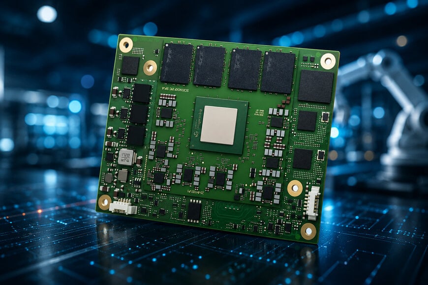

    Industrial automation, artificial intelligence, and machine learning applications are among today's most dynamic and demanding fields. To meet the needs in this area, the congatec conga-HPC/mIQ-X module has been introduced by Aaronn Electronic. This compact yet powerful module ushers in a new era for edge AI and industrial embedded systems.
    βš™οΈ Heterogeneous ARM Architecture for Edge AI​
    The conga-HPC/mIQ-X is based on Qualcomm Dragonwing IQ-X processors. These processors feature up to twelve Qualcomm Oryon CPU cores operating at frequencies up to 3.4 GHz. The Qualcomm Hexagon NPU, which boosts AI performance to its peak, delivers up to 45 TOPS (Trillion Operations Per Second) of AI performance, while the Adreno GPU complements this architecture for graphics-intensive applications.
    This heterogeneous architecture enables the CPU, GPU, and NPU to process different workloads simultaneously. Thus, tasks such as AI inference, image processing, and sensor data analysis can be performed directly on the module. This integration eliminates the need for external accelerator cards, reducing system complexity and thermal design challenges.
    The module features 16 GB to 64 GB of soldered LPDDR5x memory, supporting data rates up to 8400 MT/s. Additionally, up to 1 TB of integrated UFS 4.0 storage offers an ideal solution for data-intensive applications with fast boot times and low-latency data access.
