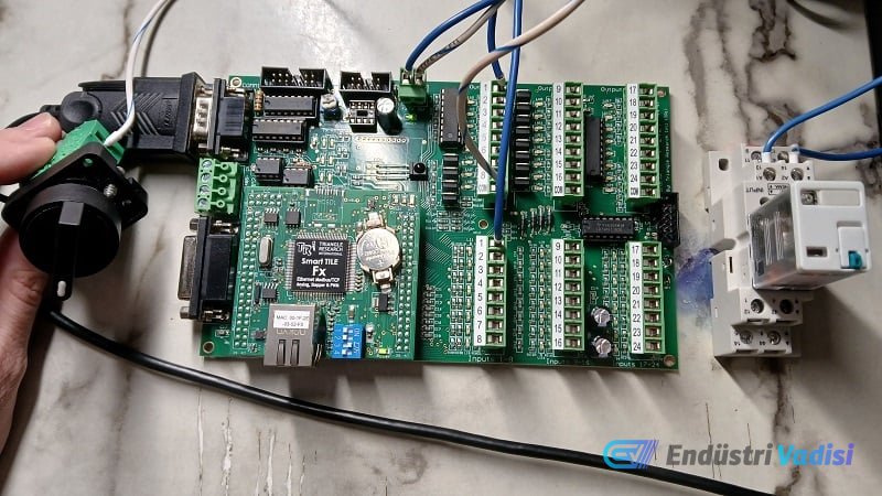

    Connection to the PLC is established via RS-232 communication using a standard USB-Serial converter cable. An industrial power supply, a selector switch, and a mechanical relay were used as input/output devices.
    The power connection is made to the header marked +24 V and 0 V. For inputs, the 0V of the power supply is connected to the switch, and from the switch to the input terminal. If a common power supply is not used, the 0V points of different power supplies are combined.
    For outputs, a cable is run from the +24 V power to relay terminal A1, to relay terminal A2, and to the output terminal. The common connection (COM) of the outputs must be connected to 0 V because the output current is greater than the input.

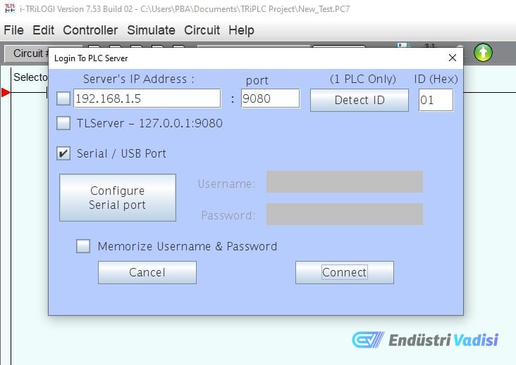

    Fx PLCs are programmed with i-TRiLOGI software (7.5 or higher). In this tutorial, the RS-232 serial port was preferred over Ethernet. The COMM1 port of your PLC is connected to the computer with a USB-Serial cable, Windows automatically installs the driver and assigns a COM port number.
    The program software is opened, Connect to Server is selected from the Controller menu, and the Serial/USB port is selected and configured. If the connection is successful, the port opens and the PLC is automatically recognized.
    In the ladder diagram, a normally open contact (number 1) is added for the input, and the terminal is selected from the I/O table or a new name can be given. A similar process is applied to add an output coil.
    After the program is completed, it is uploaded to the PLC using the Program Transfer option in the Controller menu. A notification is received when the transfer is successful.
