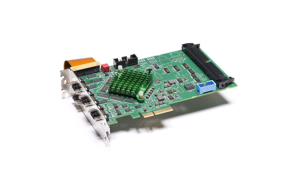

    BitFlow, Inc. announced that its Axion-CL Camera Link frame grabber was selected by NASA Goddard Space Flight Center engineers as the ground-based interface device in their Single Event Effects (SEE) test campaign.

    ### BitFlow Frame Grabber's Role
    At the heart of the test architecture, the BitFlow Axion-CL frame grabber served as the sole communication and data acquisition link between the irradiated camera system and the control computer. Installed in a host computer adjacent to the beam port, the frame grabber provided continuous real-time image capture and transmission of system commands to the PIRT 1280MVCam camera via the Camera Link standard.
    The Camera Link connection simultaneously carried image and serial command traffic, allowing NASA engineers to monitor post-test Single Event Functional Interrupt (SEFI) signatures within a single interface.
