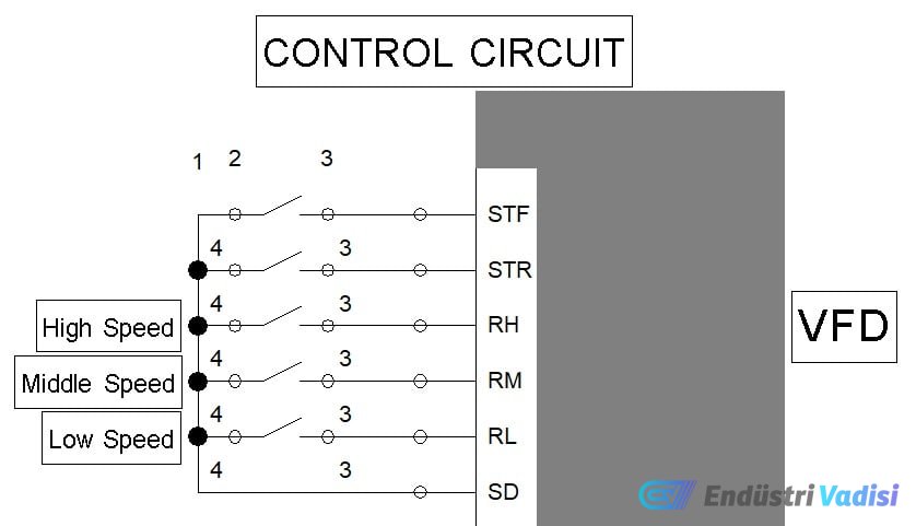

    ### Multiple Speed Options
    Drives like the FR-D700 support controlling multiple fixed speeds via digital inputs. For example, when different input terminals are activated, the motor can operate at pre-determined low, medium, or high speeds. This allows for the selection of multiple speeds instead of just one fixed speed.

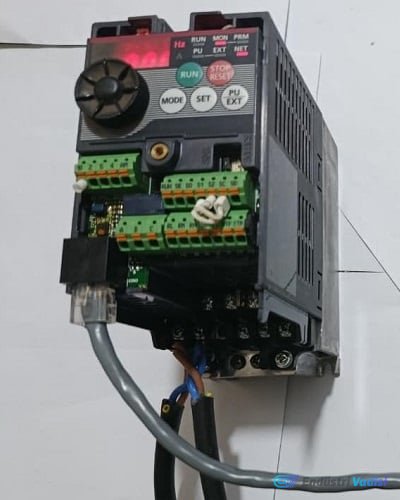

    ### Local Control
    Many VFDs offer local control to the user through their built-in keypad and potentiometer. This method is suitable for operations such as commissioning and troubleshooting, but it is not ideal for automated systems as it requires too much manual intervention.

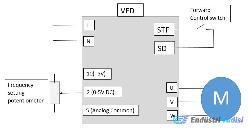

    ### Speed Control with Analog Input
    Connecting a potentiometer to the analog input for drive speed control is a common method. Typically, a 0-10 V voltage signal commands the motor's speed. This method provides low-cost, continuous, and smooth speed adjustment, but its accuracy depends on the potentiometer's rotation angle and it can be affected by electromagnetic interference.
