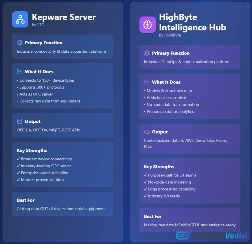

### Kepware Features
- Fast machine connection with over 150 pre-built drivers
- Centralized management panel for multi-site operations
- Conversion to industry-standard OPC UA and MQTT protocols
### HighByte Features
- Creation of reusable data models for similar equipment
- Adding business context to technical data (e.g., production line, product type, shift)
- Real-time calculation of performance metrics with edge processing
- Data quality management and version control
