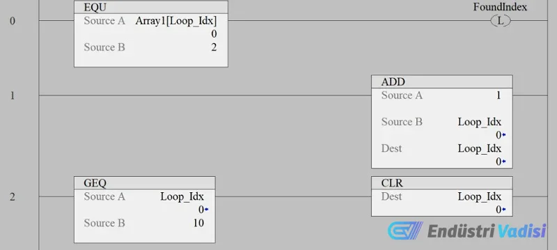

PLC logic is scanned from top to bottom, left to right. We can use this scan order to increment a pointer value and execute the logic. This method is easy for debugging and carries no risk of slowing down the processor.
For example, for a 10-element array (Array1[0..9]), the data at the pointer index is evaluated and the pointer is incremented with each PLC scan. When the pointer reaches its limit, it is reset. This method does not require special blocks and preserves the PLC's scan order.

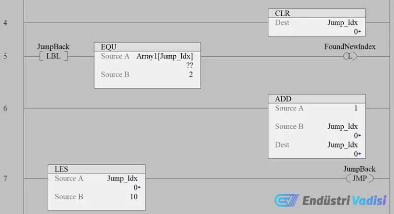

Loops can be established by jumping to labels that move up and down. In this method, the pointer indexes the array, and with each increment, new data is evaluated. The pointer is reset at the array's boundary, and the loop continues based on the jump condition.
Since the jump function alters the scan in this method, it must be used carefully. The label name must be unique, and the array must be at the very beginning.
