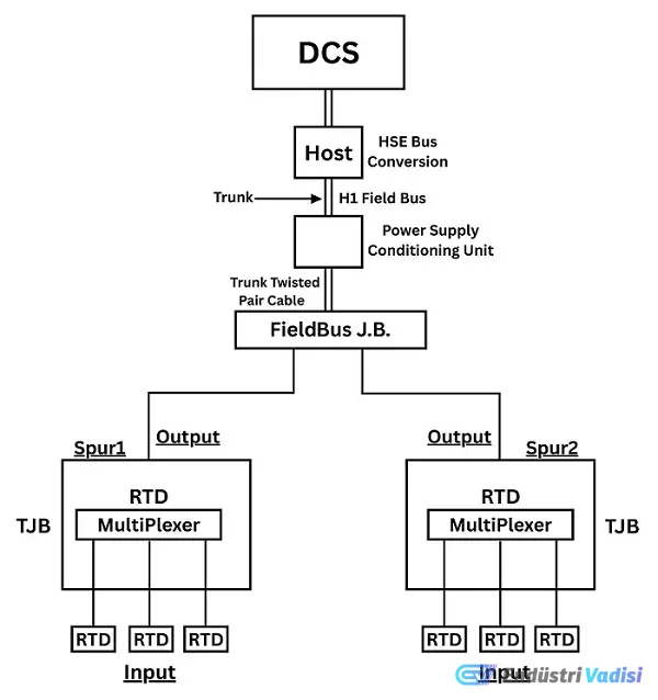

Fieldbus is a communication protocol that enables digital data exchange between a sender and a receiver. Foundation Fieldbus is a standardized digital protocol in process control that allows many devices to communicate on the same digital network.
The terms sender and receiver apply to control units such as PLCs, IEDs, and RTUs. Foundation Fieldbus transmits not only telemetry but also diagnostic and device health data. Service engineers can easily adjust device settings remotely for maintenance and troubleshooting.

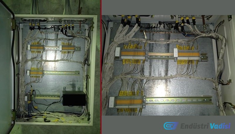

Common fieldbus protocols include HART, PROFIBUS, and Modbus. Compared to the traditional 4-20 mA system, it requires less cabling. Instead of a separate cable for each device, devices are connected to the network in a bus or star topology, and a single cable is routed to the control unit.
Multiplexers are located in the junction box and connect multiple inputs to a single selectable output cable. This way, power and communication signals are transmitted over a single cable.
### Fieldbus Key Terms
- Trunk: The main communication line to which other cables are connected.
- Spur: A branch cable connecting devices to the trunk line.
- H1 Bus: A fieldbus that uses a 2-wire twisted pair cable to connect devices in the field.
- HSE: High-Speed Ethernet network across the plant.

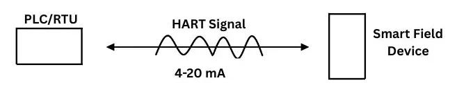

HART (Highway Addressable Remote Transducer) is an open standard protocol widely used in control and instrumentation. It provides digital communication over the analog 4-20 mA line. It adds additional digital information to the 4-20 mA signal using the Frequency Shift Keying (FSK) method.
HART provides half-duplex communication and transmits data at 1200 bits/second. The digital signal operates at frequencies of 1200 Hz and 2200 Hz; 1200 Hz represents bit "1", and 2200 Hz represents bit "0".
