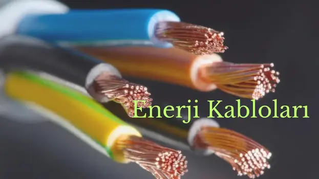

Energy cables are critically important products that ensure the reliable and efficient transmission of electrical energy. The correct cable selection for energy transmission, paying attention to color codes for compliance with standards, is suitable for system safety and long-term use.
Operating with color codes globally and in our country helps ensure consistency in cable usage. This way, even years later, there will be no problems with fault detection or system renewal.
