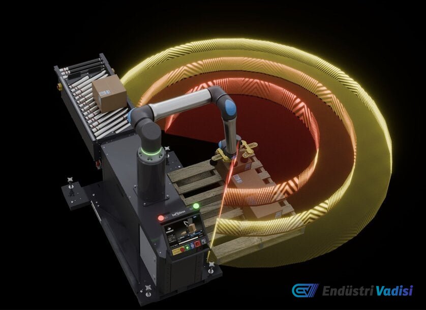

3D Dynamic Safety Module from beRobox​
To modernize material handling safety, beRobox introduced 3D Dynamic Safety, an arm-integrated safety module designed for the PALTZ robotic palletizer portfolio. This module, instead of confining safety zones to static boundaries around the workstation, mounts sensing instruments directly onto the articulated robot arm. As the manipulator moves, the sensor moves with it, creating a volumetric safety zone that dynamically adapts to the robot's real-time trajectory and coordinates.
Seamless Operation with Smart Zone Management​
This localized, dynamic awareness allows the palletizer to selectively manage operator interactions without initiating unnecessary full-cell shutdowns. During dual-bay palletizing sequences, an operator can enter an adjacent pallet station to remove finished loads or position empty pallets, while the robot arm can safely continue stacking in the active station. The sensor provides continuous presence detection as it constantly monitors the 3D space around the tool at the moving arm's end. If an operator remains in the robot's active zone, the system prevents unwanted restarts until the envelope is completely clear.
