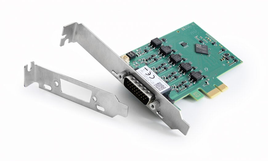

The Kvaser PCIe 4xLIN is a four-channel, compact LIN interface card specifically designed for desktop, industrial, and HIL (Hardware-in-the-Loop) environments. The low-profile PCIe card, with galvanic isolation and synchronized timestamping features, enables engineers to gain reliable system-level visibility when testing and debugging LIN networks.
βββββββββββββββββββββββββ
βοΈ Precise Timing and Scalability
This card offers four separate galvanically isolated LIN channels through a single PCIe slot. Thanks to the FPGA-based Kvaser LIN-IP technology, communication speeds of up to 20 kbaud and a 1 Β΅s timestamp resolution are achieved. This allows time-sensitive events to be captured with high precision. Furthermore, with support for simultaneous operation with multiple Kvaser interfaces, test setups can be easily scaled as system complexity increases.
