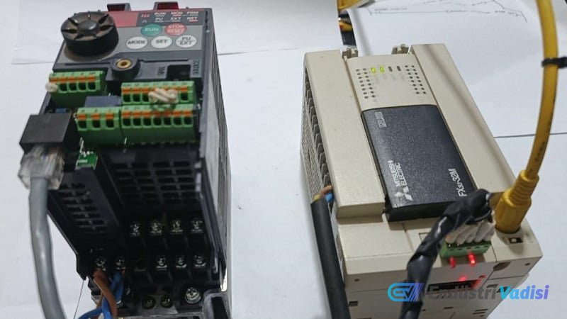

This guide describes the setup of RS-485 communication between a Mitsubishi FX3U PLC and an FR-D700 inverter using the FX3U-485-BD communication board. Speed control and system monitoring can be achieved with ladder logic.
In industry, motor control is often done via digital communication rather than separate digital and analog cables. The PLC and VFD are directly connected via a serial network method like RS-485. This simplifies wiring, eases diagnostics, and allows for motor speed control directly from the PLC.

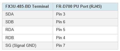

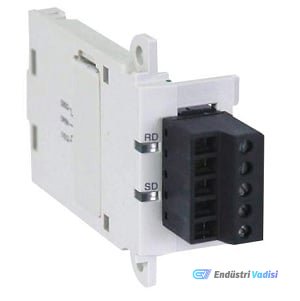

The example system uses the FX3U-485-BD expansion board of the FX3U PLC. This board enables serial communication with shielded twisted-pair cable and connects to field devices like the FR-D700. The VFD, with its internal RS-485 interface, supports Mitsubishi protocol and Modbus commands. For correct connection, it is necessary to use the SDA and SDB differential signal pairs and the SG ground reference.

- Communication board: FX3U-485-BD

- Communication standard: RS-485, 8-pin RJ45 connector (Note: RS-232/RS-485 is generally not 6-pin RJ12)

When communication is established, the SD and RD LEDs on the FX3U-485-BD board flash. If only SD is lit, no response is being received; this indicates reversed wiring, incorrect address, or setting issues.
