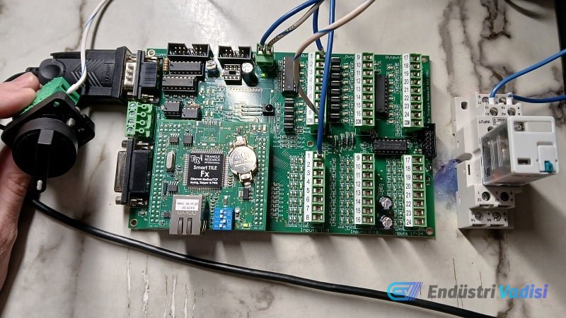

    ### Hardware Connections
    • Connect the power source to the +24 V and 0 V pins.
    • Since the inputs are sourced, connect a cable from the 0 V source to the switch, then from the switch to the input terminal.
    • If different power sources are used, the 0 V lines must be connected for common return.
    • Since the outputs draw current, +24 V is connected to the output relay, the relay output is connected to the output terminal, and the COM terminal of the outputs must be connected to the 0 V power supply.

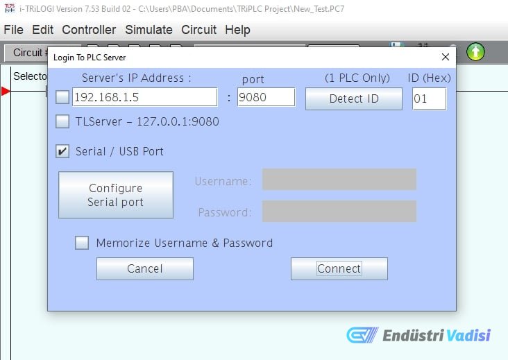

    • Fx PLCs are used with i-TRiLOGI software version 7.5 or newer.
    • For connection, the PLC's COMM1 port is connected to the computer with a USB-Serial cable.
    • Serial port configuration is done via the software, and connection to the PLC is established.
    • A simple ladder logic program is created by adding commands in the green workspace, and input/output points can be selected from the I/O table.
    • After the program is completed, the program is transferred to the PLC from the Controller menu.
