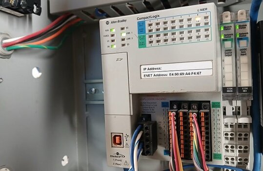

    ### 1. Input/Output (I/O) and Module Flexibility
    Many PLC series offer models with some digital and analog terminals embedded in the CPU. This means that initially, you might only need to purchase a single product. Different model numbers may exist for digital and relay outputs, input types (sinking vs. sourcing), or analog options. Making the right choice can lead to significant cost savings.
    Also, pay attention to the ability to add additional modules later. Embedded I/O might be sufficient for now, but support for more modules provides an advantage for the future of your project.

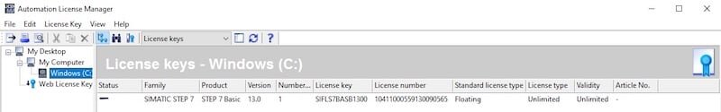

    ### 2. Software Licensing Options
    PLC software varies; there are often free or low-cost entry-level versions that offer a limited command set or program size. There can be cost differences between annual subscriptions and perpetual licenses. While engineers generally prefer perpetual licenses, they pay attention to whether software updates are included.
    License keys can be obtained via USB dongle, hard copy, or digitally (via email). Some advanced software is offered without licensing and purchase costs, which is ideal for small projects and learning, but cannot be used without purchasing PLC hardware.

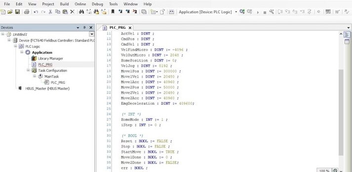

    ### 3. Programming Languages
    The IEC 61131 standard defines three official PLC languages and two languages from earlier revisions. The most common languages are Ladder and Structured Text in North America, and Function Block Diagram and Structured Text in Europe. Your software supporting multiple languages provides an advantage for learning a new language. Who will read the program in the future and troubleshooting capabilities also influence language selection.
