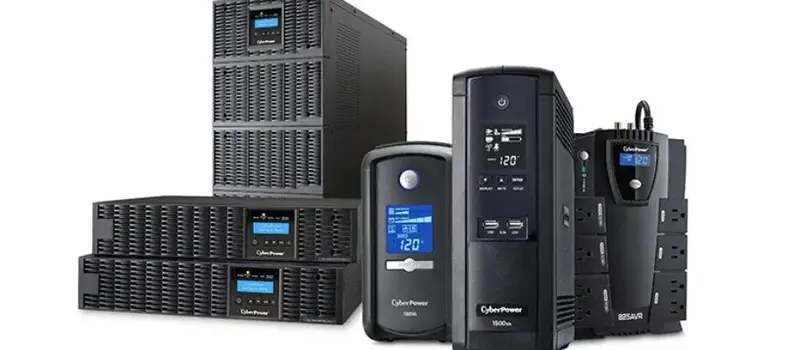

Distributed UPS
Distributed UPSs are mounted directly in or next to the server rack, so that (potentially) every server has UPS hardware connected to it with almost no space between the hardware and servers. A distributed UPS can be likened to flashlights illuminating every 4.5 meters of a space, whereas a centralized UPS can be likened to a giant floodlight casting light in a 30-meter radius. If one of the distributed UPS’s flashlights goes out, it only darkens the 4.5-meter area around it; if the centralized UPS’s floodlight temporarily goes out, everything metaphorically goes dark.
Reliability: Power in Proximity
In a business’s IT network and electrical grid, the greater the distance between the server and its associated UPS, the greater the risk of power issues, such as noise, grounding, and/or loose connections. Since distributed UPSs are mounted in or adjacent to server racks, the distance between them is shortened, significantly reducing the likelihood of faulty wiring along the power chain. By providing independent auxiliary power throughout the network, mass power outages that can occur when using a centralized UPS are avoided.
Ease of Installation and Integration
Due to their lighter weight and greater portability, distributed UPSs are much easier to install and move around, making them ideal for companies that need greater mobility in their data centers. Proximity to server racks also optimizes the location of distributed UPSs to Ethernet connections.
Better Cost Control for Smaller Organizations
Since distributed UPSs are designed to support a single server rack within a network, rather than an entire business’s network, the initial cost of purchasing this solution is significantly lower than that of centralized UPSs, which are often overkill for small and medium-sized businesses (SMBs). Compact UPSs have the same lifespan as server hardware, which allows organizations to economically synchronize their server hardware and redundant UPS upgrades. When smaller companies need to expand their backup power protection, they can choose to increase the redundancy of their system by adding additional UPSs as needed, at a much lower cost compared to a centralized UPS.
Disadvantages: Inefficient Management

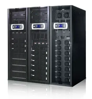

Hybrid Solutions
Modular UPSs can create a more robust backup architecture for many critical operations in medium-sized data centers. With modular UPSs, organizations can increase backup system redundancy by installing additional power modules when needed, thus providing the efficiency of a centralized backup system and the gradual growth (and costs) of a distributed system. At full capacity, the three-phase Modulon DPH Series offers the highest possible availability:

Hybrid Solutions
- 25kW to 75/150/200kW of continuous power and an additional 800kW capacity in parallel
- Mean time to repair (MTTR) is close to zero
- Integrates with existing power distribution in a parallel rack or the same rack
- Self-synchronization of power and control modules supports continuous online operation even if the control module fails
- High overload protection – 125% overload for 10 minutes and 150% overload for one minute
- Expands up to four units without needing additional hardware
- Built-in manual bypass eliminates maintenance-related outages
Alternatively, a hybrid backup architecture that incorporates both centralized and distributed UPSs can offer a solution that covers more ground and compensates for the weaknesses of one system with the strengths of the other.Conclusion and Summary
